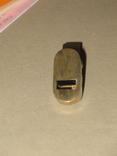

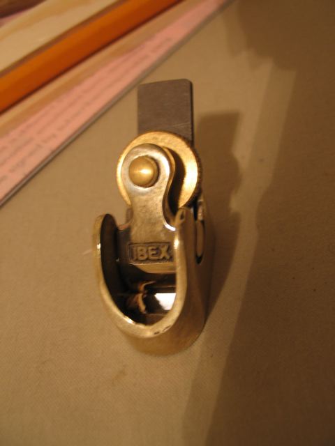

Hey guys,
I just bought this Ibex finger plane with a 10mm blade to voice braces
and
the like. The thing is that it doesn't take smooth strips of wood. It's
really
rough and kind of gouges little pieces instead of smooth strips. Is it just
the
blade being dull? It feels pretty sharp or am I just doing something
wrong
(which could very well be the case)? Here's a couple of pics of the plane.
Thanks guys. I'm sure you have the answers...as usual.
Peace,
Ross

hi ross,
from the pics it looks as though you may have the mouth of the plane set too coarsely, (in other words there is too big a gap between the tip of the blade and the brass housing)
of course having the blade super sharp is very important too, i would try sharpening the blade, and then settting the blade about 1mm away from the brass lip, or until there is approx 1/64th of blade protruding above the casing,
i have used one of these little guys for quite a whilee, and they are great when set up right
paddy

Looks like you might have the blade upside down. 'cause Paddy's right, the mouth is open too wide. Bevel side should face down.

yeah you have the blade in upside down. The plane is most assuredly
NOT junk. I love that plane, and use it everyday. Flip your blade over and
that will allow you to close the mouth on it, and get fine shavings. The
blades come ready to use..in fact I've never sharpened mine since I got it
(a few years ago), and it still takes razor clean shavings (of course I really
only use it on mahogany, and spruce) The blade should look like a chisel
held upside down when mounted in the plane.

I second what John said. The blade is upside down. I had the same problem when I got one of these things and I was about to throw it against the wall. Luckily I decided to flip the blade and see what happened. It's been an extension of my fingertip ever since.

The way I have the blade set is bevel side down. Is that not the right way? If
I flip it the angle seems that it would be to steep. Let me know. Thanks.
